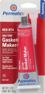

I've never done any freeze plugs, but to my understanding it is meant to be a metal to metal sealing without any sealant. I'm sure that works fine on a new assembly, but the second time I would use sealant. I saw somewhere that Permatex 81160 High-Temp Red RTV was recommended.
Thank you, I asked a large core plug specialist also and they advised I should use Dirko sealant on replacement plugs so I have a tube of that anyway.
