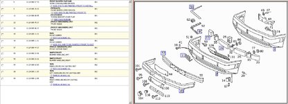

I need to replace my front bumper.
There obviously are a lot of parts in the EPC (see photo).
Does it normally come complete? Partly complete, or do I have to order every part in the photo? If complete, does it indeed include all parts on the picture?
The so called "front bumper face bar" - no 5 is broken on the right side a few inches from the edge. Also the front bumper "rail" - no 49 is toast.
(the other ones marked in the photo probably needs replacement)
What is the difference between no 5 and no 8 - they look identical..?

Item #5 includes item #'s 8, 11, 23, and 26. Note that these four item descriptions appear in the list with a period before the description, indicating they are part of the higher level assembly listed above them in the list.
The face bar (impact strip, #49) is sold separately, but can be re-used if undamaged. You'll need to swap over some of the mounting hardware from the old bumper to the new, unless you want to buy all new stuff. Shouldn't need to replace the foam behind the impact strip.
