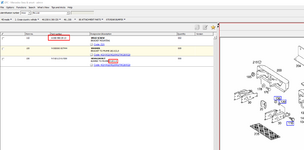

A0009902913 or 000-990-29-13 should be the studs you are looking for.
000-990-29-13 may be for a machine threaded stud, M14 x 1.5 ... ??
There is conflicting info in the EPC for 000-990-29-13: Probably need to order one of each and see what show up.
Dave, I noticed that as well, and based on a picture coming up it looks like the wheel lugs pressed in the wheel hub flange.
It is confusing that this PN (A000 990 29 13) is listed as a replacement in that table I posted above (post #10) - a replacement for that coarse threaded 5 mm welding stud..?? Must be something wrong in that table, but it does at least list those welding studs.
