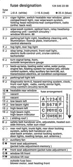

Can any one direct me to this fuse? Wiper works does not pump fluid and when I hold the button long enough my headlight wipers do not go on as well.

open up your fuse box, you should have a legend under the lid. 5, 15, 17 check and see if any of them are blown but specifically, look for the legend.
The windshield pump is controlled from the combo relay, I think?
The headlight wash/wipe only works if headlights are on AND you wash the windshield. What happens when you do that?
:124:
Thank you both. Dave, they do pump. I have not used them in ages if ever and did not realize they had to be one.
