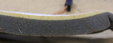

If anyone is considering installing these themselves I recommend getting additional 4 or 5mm foam to properly fill out the pockets. The factory heating pads can become compressed and new are no longer available, at least the bottoms. I took the first bottom cover back off to add additional foam and it made a very noticeable difference in look and seating comfort.
