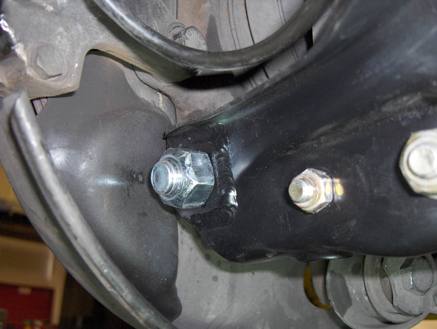

Photo of the business end of a RDM TEK LCA is below. The outer attachment point is relocated approx 5mm inward for a fixed amount of camber reduction. They change the rear camber by approx -1.25° or so, ±0.25°. This is just about perfect for most 500E/E500's, either stock ride height or lowered. They really are not needed with stock suspension & stock wheels/tires; however if you either have lowered the car and/or have wider wheels/tires, the camber reduction will help prevent the inside of the rear tires from wearing to the cords.
Please note that if your 500E/E500 is lowered *at all*... i.e., even stock springs with thinner pads & tweaking the SLS slightly... you are very, very likely to need additional toe adjustment. The only way to know for sure is to get an alignment at the dealer after installation, and see if the rear toe can be adjusted into spec. If not, you'll need the factory rear tie rod eccentric bushings, p/n 124-352-43-65, two required (current MSRP is $182 USD each, and no that isn't a typo). Yes, they are obscenely expensive, but there is no other easy/affordable solution that works well. See attached for a pic of the eccentric bushing. (FYI - urethane bushings like K-Mac will sqeak, no matter how much lube you apply; the factory bushing is completely silent.)
Click here to see the dealer alignment sheet on my 1992 500E after installing RDM TEK rear LCA's and also the factory eccentric bushings, at slightly below stock ride height (rear end lowered approx 0.25"). I did not have an alignment done with stock LCA's or stock tie rods, so I do not have a 'before' sheet for comparison.
Note: I always have the alignment done with a full tank of fuel, this shows the camber at max negative and ensures the toe is set at worst-case scenario. WIth SLS there isn't a big difference between full & empty tank, another option is to align with 1/2 tank of fuel... this may be the FSM recommendation.

Here are a couple of photos on GSXR's "web site" (LOL)
Humm.. is it the welded gusset at the outside?
Dave- can you align a non-lowered car with these?
Humm.. is it the welded gusset at the outside? Dave- can you align a non-lowered car with these?
Yep, plates are welded on the outside, as shown in the photo. Matching (longer) bolts/hardware is included. Works great, only potential issue is the toe adjustment as I described in post #3.
There should be no issues with aligning a non-lowered car; however your RENNtech may not necessarily be at stock ride height. Measure from wheel center to fender lip with a full tank of fuel after the car has been sitting overnight and see what you get.
