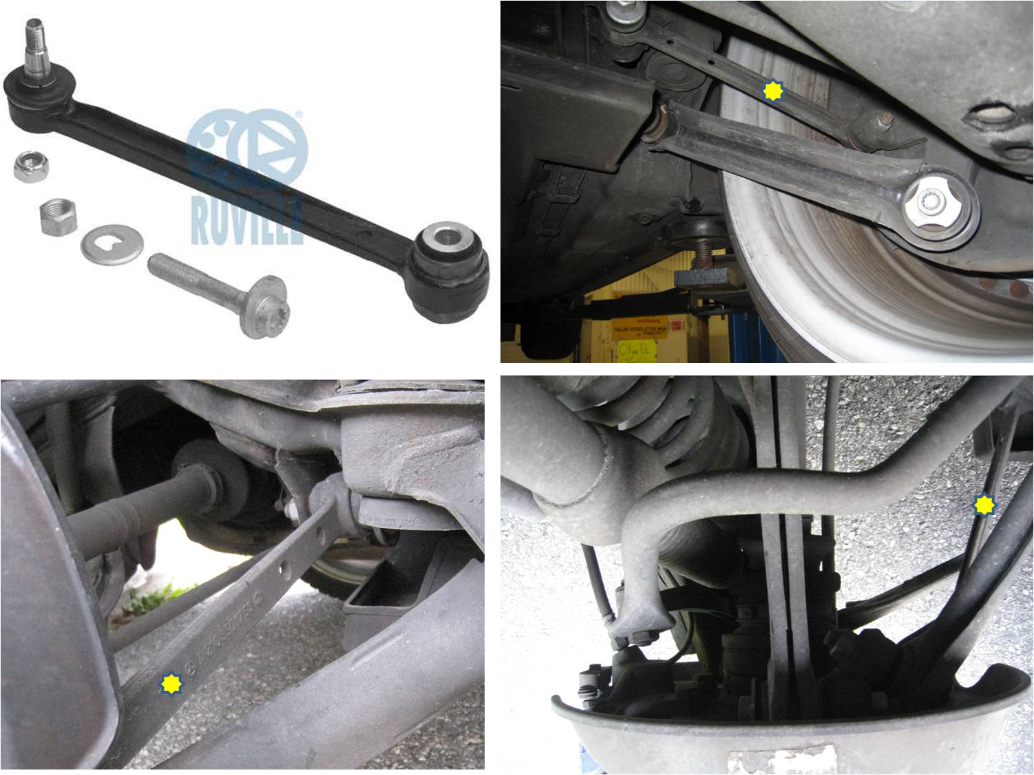

I would advise NOT putting the RDMTEK LCAs on your car unless you are modifying the tie rods at the same time. My factory tie rods were at their max inward adjustment when I installed my RDMTEKs and my car shredded a brand new pair of tires faster than I could get to an alignment shop. It was worse than before I installed them.
After modifying my tie rods ala Glen, all is well and my alignment can be brought into spec.

I have a question on this, and I am asking with an honest, straight face. My understanding is that tie rods are part of the steering mechanism, on the front of the car. THe RDMtek LCAs (at least the ones that I had commissioned through Austin's dad, last year) are part of the rear suspension, to help with camber adjustment to avoid wear on the inside of the rear tires.
How does a tie rod adjustment on the front suspension, directly affect the overall geometry and camber (and associated wear) at the rear tires? Is there a correlation on this? Are there adjustable tie rods on the rear suspension?

FYI :apl:
The PN is 210-350-21-35, but on my SuperMerc it is 210-350-17-53, a PN upgrade/merge maybe?
Glen had the right answer. Some call them tie-rods on the rear of the car as well, although toe-link is more appropriate.
As a further explanation, imagine the links of our setup in question; LCA and Toe-Link. Hold out your hand vertically to represent the wheel. Now use your index finger from the other hand to represent the toe-link and hold it 90 degrees against your palm (aka tire). Now imagine your middle finger is your LCA, and hold it below and to the center of your hand relative to the index. You install a shorter LCA and to represent this, angle the bottom of your hand inward at the point of your middle finger. Of course, the center rotation axis of the tire cannot move inward due to the driveshaft, and neither can the forward portion due to the toe-link. So what must happen? The rear and lower portions of the tire will. Great for camber correction, bad for toe.
