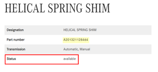

Dave do you know by any chance if this spring shim is available at all or NLA
#201-321-12-84 this is the 23mm
It appears the 4-pt pad 201-321-12-84 has been replaced with version 201-321-12-84-64, that should be available, but may need to come from Germany? There are aftermarket brands also available. All the RevParts sites show Backordered / Currently Unavailable so you'll need to contact a live person at a dealership.
MBCC:
MBCC:

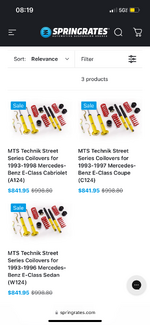

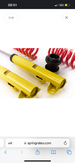

<rant>
These are not "coilovers". It's getting really old seeing wrong terminology applied to aftermarket kits, probably because the kids these days think "coilover" sounds cool and they want it. What's being sold above (and, by SF Racing in Taiwan) are ADJUSTABLE SPRINGS with separate, custom dampers. The spring design includes a threaded collar/plate assembly which replaces the stock rubber pad, and that combination allows ride height adjustment with the included spanner.
A true "coilover" integrates both the spring AND damper into a single unit, where the coil sits "over" the damper. This design is a Very Bad Idea for any 124/129/201 chassis because the suspension was never designed to support the full weight of the vehicle on the strut or shock tower upper mounts. Thankfully there are very, very few true coilover setups offered for the 124.
It's still annoying to see misleading advertising / marketing. In this case, the MTS Technik don't even offer adjustable dampers, which is additional misinformation, apparently an error on their PDP (Product Detail Page). The "standard features" list includes "Adjustable Shock Absorbers", yet the specifications clearly state damping is "Non-Adjustable".
Also annoying is that none of these places show photos of their exact product actually installed on a 124 chassis. Have they even tested them on a real car?
:oldman:

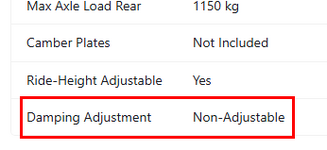

yes its a little bit all over the place with the product description, i was hoping on those guys from youtube video do tell how is the ride but they never followed up with another video, i guess if someone will buy a set and do some testing, also they dont have a kit for Wagon, and they looks like are using Eibach springs, wich makes me think🤔 , probably the only good part from the kit is the custom damper thing for adjustability, i feel like you can use that thing on a regular spring
whats your opinion on price?
MTS Technik price at $850 isn't terrible, but not a great deal either. It's on par with buying a set of standard aftermarket springs and sport dampers. ALl you are getting is finer adjustability with ride height, plus no-name dampers of questionable quality.
SF-Racing, still don't know the price, but the same thing kinda applies. Their kit at least has single-adjustable dampers, likely adjustable rebound only, like KONI.
Both of these kits have a single spring rate, which may or may not be ideal for your particular car. This is why I prefer the factory Sportline setup where possible, MB engineers already did the nerdy stuff to figure out what worked well for a specific 124 chassis.
