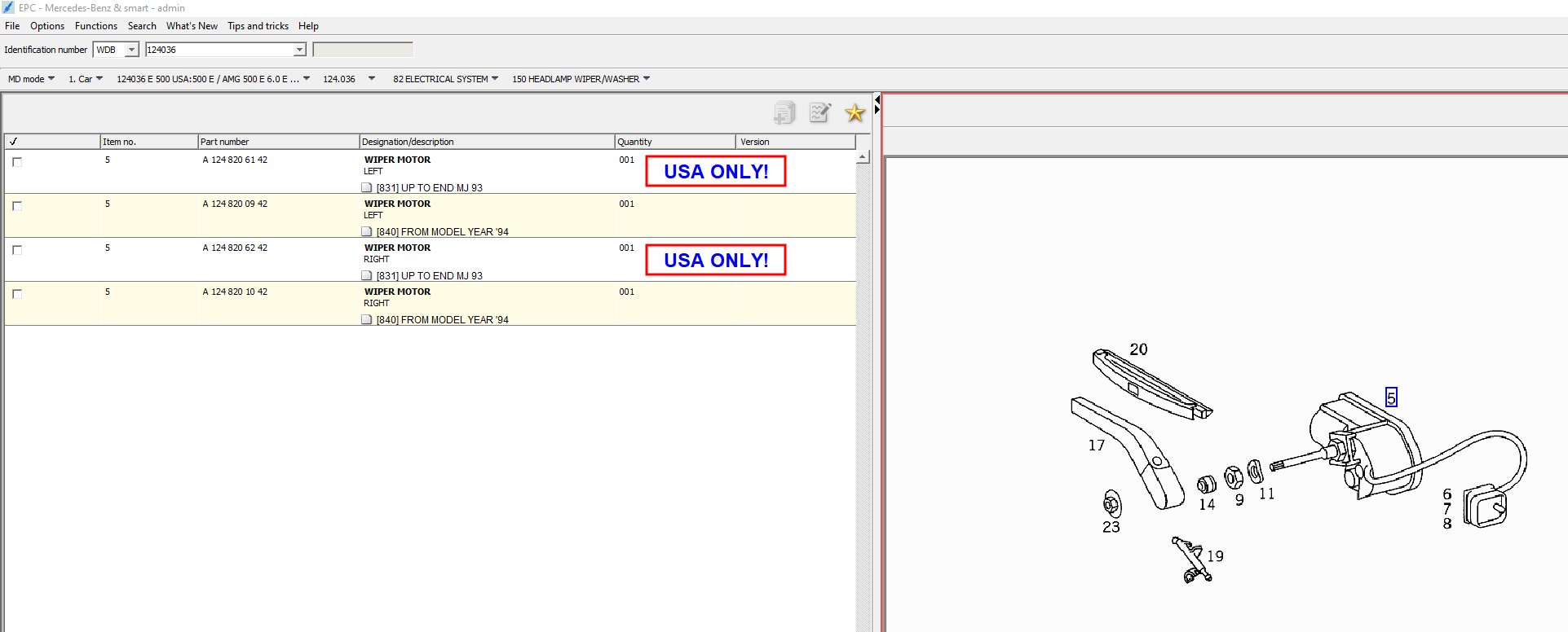

Your part numbers are backwards, btw... EPC screenshot below:

Interesting... the numbers A1248202142 and A1248202242 are early-version Euro motors, replaced/superceded to 124-820-09-42 and 124-820-10-42. Never seen them before!
