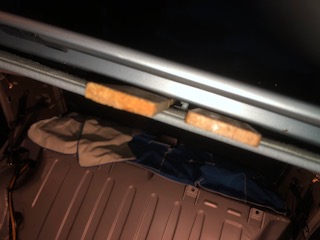

I want to mention a comment about the sunroof panel removal. There are 4 plastic white Christmas tree attachments that must be popped at the front of the sunroof while half open. Rather than pulling and perhaps bending or breaking the panel I used wood wedges and rubber mallet gentle on both side of the connectors. They POP when open. This worked very well and the POP tells you so. Make sure to use rubber mallet or you may hit the edge of the sunroof paint when pushing the wedges inward. There are 2 on each side and they are loud when they pop open. See picture below. The third picture is the unit after foam removed and fourth the FOAM.

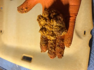

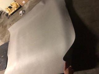

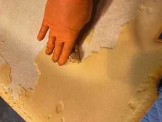

So then oddly enough the best tool for me to remove the "foam" ended up being a good pair of shop gloves. My foam looked intact but upon close inspection was shot so it had to come off. You have to use gloves because this stuff is super sticky and anything it touches will have to be thrown out period. Get that foam goo away from you and make sure and prepare for mess! Through process of discovery rolling a ball of foam goo over itself worked the best and did the least damage to the fragile under surface. See these pictures of my process and the ball of goo at the end. Two or three good gloves that can be thrown away required (once you start this you will not be able to touch anything with the gloves so have extra). The third picture is just laying the foam for fit dry.

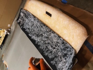

Then once you cut the foam and have it laid where you think it best start at the back to create an anchor point. See below pictures of the start glue down. It took me close to 2 cans to do the foam project and I have yet to do the vinyl. Start here in the back then switch sides. Make sure to get glue at the bottom so when you fold over the panel and do same on the back there will be no missing glue seam. Use the glue properly per instructions. MAKE SURE YOU PUT COMPLETE GLUE ON BOTH SIDE especially where the groves or channels are down the sides because you have to have complete contact there or you will get unhappy sag before you are even done. Mine came out OK but this has to be done carefully with complete glue.

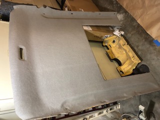

Note the trimmed edges. Does not look great at this point but OK. I will advise when the new vinyl goes down. I just used a razor and cut along the edges. Must be super sharp razor and it took me four. Also on old vinyl removed; Don't forget to remove the plastic inserts in the old vinyl where they tucked into the sunroof hole.
The above is the FOAM only on the headliner so now the vinyl job is next. I have to work to pay for this stuff so will finish later.
PAY SPECIAL ATTENTION TO THE CHANNELS ON BOTH SIDES AS YOU HAVE TO MAKE SURE TO LIGHTLY PRESS EVERYTHING IN SO THEY ARE SECURE. PUT ENOUGH pressure but don't over do it. The fabric side and the liner side must have glue and be connected only when tacky. Timing must be perfect. Looks rough to me and the panel on the sunroof a bit intimidating but more later. I am doing vinyl tonight. This project takes 3-4 cans of glue based on my 1.6 cans used just for foam glue down. I assume vinyl will take same amount. I also hope the vinyl will smooth out some of the roughness seen in the foam.
