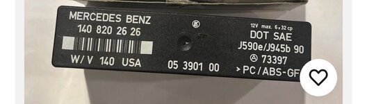

hi I have a 1995 s class and the indictor (I think) relay was not working and when I went to remove it wires from the left side fell out need diagram

I have a 1995 S class and the wiring fell out of the relay does anyone have the wiring diagram to put the wires back in the correct pins

This is from a 1990 SL combination relay (A.K.A. the N10 Relay) which also has 21 pins the same as yours (albeit a different part number) with 18 cables into the 21 way connector.
I HAVE NO IDEA IF YOUR CAR WIRING IS THE SAME SO PLEASE DO YOUR OWN RESEARCH
1BLANK
2GN BU
3GN BK
4BLANK
5BLANK
6BK BU GN
7RD WH
8BK YE
9BK YE RD
10GY BU RD
11GY
12BK BU WH
13BU
14GN
15BK WH
16GY BU
17BK GN WH
18BN YE
19BK GN
20BK
21GY

Thanks I did my research and found that this is different as PIN number 16 on the one you sent is GY BU but on the box itself there is no pin but thanks
Mate that looks exact it has the number 16 pin missing as a blank and at quick glance the colour codes look goog
I appreciate all your help
