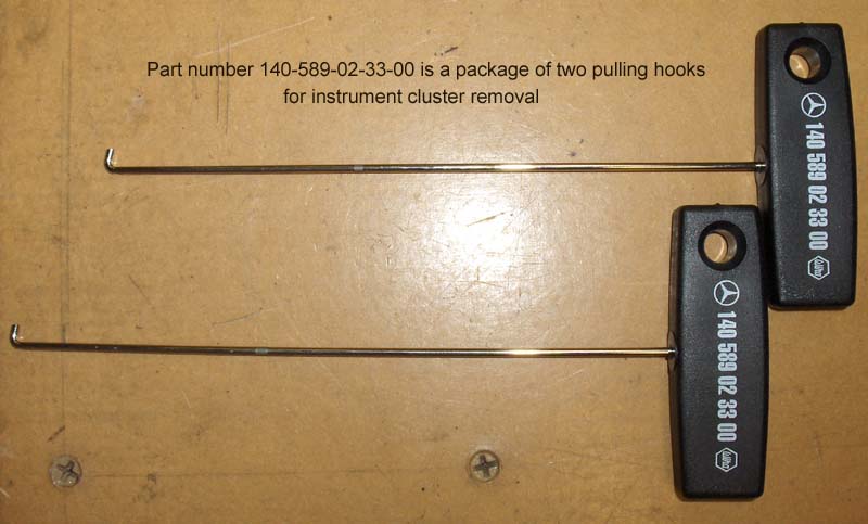

Glen is correct. NO need to mess with the lower dash panel. Extend the steering wheel all the way out (to make room), then use pulling hooks on each side of the cluster to wiggle it out. If the cluster has not been removed in a long time, it can be quite tight. Bend up some thick wire coat hangers to duplicate the fancy factory hooks shown below:
:mushroom:
You can get away with using two coat hangers, bent in a similar shape to the factory hooks that Dave shows above. THe factory hooks are around $12.00 a pair but you can use coat hangers with a loop in each end to serve as a handle. I used coat hangers for years. You insert them at around 10 and 2 o'clock and pull the cluster straight out (after extending the steering wheel out as far as it will go).

OK - a little more tugging with my home-made tools and it was out! I feel kind of silly for taking apart the lower trim panels.

My tools worked. Thanks so much for the advice. I am going to the dealer to buy some bulbs.
