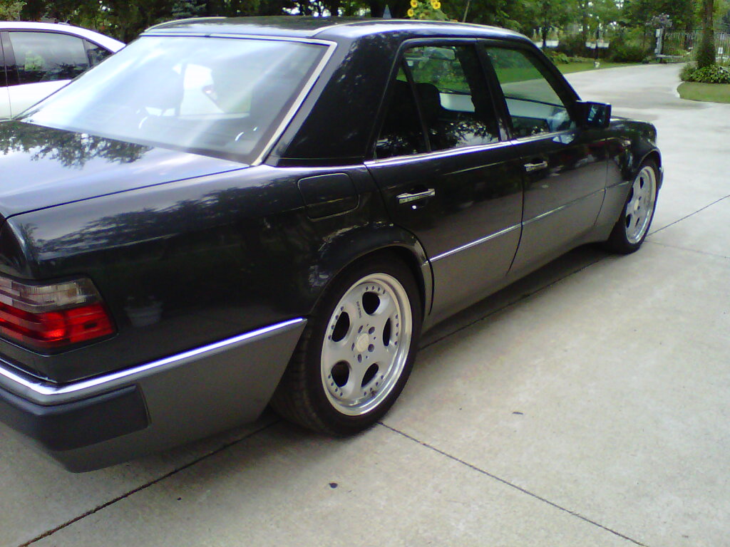

I'd be half tempted to bring my beater W210 after not washing it for months (040 black, in farmland), just to see how many people would faint at the sight of it. Maybe stop by the local fast-food joint to pick up some burger wrappers & fry containers to strategically place around the interior. LOL. :D
Jlaa, I think your door jamb is cleaner than some of my entire cars. There may not be enough Q-tips in the world to rescue my fleet...
Hah! You should. I am familiar with anti-OCD. However I live in NorCal which means gobs and gobs of idiotic Uber/Lyft drivers. Also, I live in a city, which means lots of parking by braille. So I have a beater car for that.
Well, finally, I am finished wasting away precious hours of my life on a Sunday afternoon cleaning door jambs. And listening to the Outside Lands Music Festival. My whole neighborhood hears the concert --- playing in Golden Gate Park right now.
Official Beater Car of NorCal Below:
