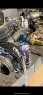

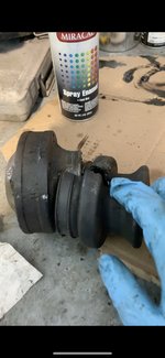

I'm currently doing this job and axl shafts+parts have been sandblasted+painted with 2k epoxy+polyurethane paint and now waiting for new boots. I have my boot clamps yellow plated also.
