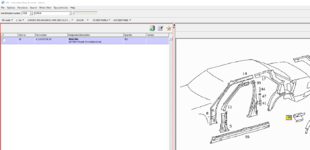

I am after a picture of the rear battery area, ground cable location and how the main power cable runs to the battery, I ask for these images as I’m building a 500e replica and have just finished installing the rear 1/4’s
Some pics here
The 500E battery compartment is unique to that chassis and also NLA. Maybe other members can advise if 400E battery compartment will work better for you. Assuming that would be a better fit and maybe you can find a donor car to cut the sheetmetal from
The 400E and 500E battery compartment areas are quite different from one another, and I don't know that a 400E battery compartment is that easily adapted to a 500E. This may be a situation where something custom-fabricated along original 500E lines may be the better way to go.

Sorry what I meant was I think the OP has a non 500E 124 and wants to add a battery in the trunk retrospectively which is where a 400E item may be a better fit.
When he says new 1/4s fitted does he mean 500E items?

My vehicle was originally a w124 230e, few years back I purchased a 500e rear clip from the US and got it sent to Australia. I have installed the rear quarters and now doing electrics so that’s why the images are required to give me a idea of how I should proceed with the battery cables
