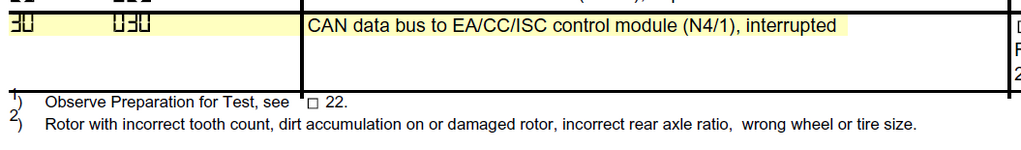

My indi is trying to track down a very intermittent problem, where the ASR light will randomly illuminate, and the engine drops into limp mode. Turning the engine off/on cures the problem - until the next time, which could be almost immediate, or 12 months away!

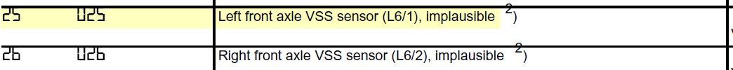

Fault reading indicates a problem with the front driver's side ABS sensor - but at the same time, we're getting ABS Code 30.
My questions are:-
Does an ABS sensor fault trigger Code 30?
Does an ABS sensor fault trigger limp home mode?
Is the Code 30 a ghost code, which then triggers limp home mode, or does the limp home mode trigger the Code 30?
If the Code 30 is real, what am I looking for?
Over the years, all the usual suspects, i.e. wiring harnesses, late date ETA etc. etc., have been renewed.
Any suggestions would be gratefully received.
Limp mode triggers ASR code #30, which is a generic ghost code that can be ignored. It is a red herring.
Are you also getting ASR code #2 or #25 for left front VSS (L6/1), driver side ABS / wheel speed sensor?

Interestingly, I do have a brand new E-GAS module I could try for grins?

As I understand it, the front ABS sensor fault would not have triggered the limp mode?

Correct - an ABS sensor fault should not have triggered limp mode.
The limp mode triggers both the ASR light and also the ghost code #30.
