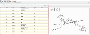

I have looked in the EPC for the cable lockout between the gear selector unit and ignition switch but can’t find it. I’ll have to dive into this next although I haven’t decided which end to examine first. I’m trying to determine if the cable is still available in the event I need one.
Jon, the shifter mech & cables are in EPC Group 26. Both the cables are NLA per the MBCC site, although I'm sure plenty are available used from junkyards.
Either or both of the interlocks (ignition switch & brake pedal) can be bypassed/eliminated if desired. Early 124's did not have these, the interlocks were added for MOPF1 (USA 1990 model year) IIRC.
Thanks Dave. I looked for an hour but didn’t see it. I didn’t realize that the brake lockout is mechanical (cable) too. This helps.
