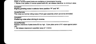

Also I found this in 722.3/722.4 service manual. Screenshot_20250807_092159_Adobe Acrobat.jpg

Also I found this in 722.3/722.4 service manual. View attachment 220004
The sound is not comparable with that "flowchart/diagnosis sheet." This is more relevant to those typical reverse issues,
