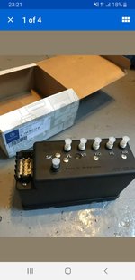

Say hello to my latest Ebay purchase
A brand new W140 Soft Close pump :cloud9:Aparantly NLA according to seller but never checked that myself.
(3x spare now - 1x per 140)
Only a very small, narrow group of people on this planet can actually understand on a quantum level why acquiring 3rd brand new is soft close pump is :cloud9: feeling 😁
Sorry I meant 3 spare with the other 2x being good used pumps. (One is 2015 or something like that) and this new one giving 3x total spare.
Have been stepping up the hoard recently. Bought 4x w140 tool kits also spare in last couple of weeks and aiming for 12x :noevil:
Yes I figured these were pricey! But I lucked out since this was an ebay auction and the seller had made a mistake in their listing. They had it listed as used under the Ebay setup but described as brand new boxed unused pump in description.
Only one other bidder and at the last possible second I dropped a £300 bid and to my surprise the other person only had £100 bid on it so got it for just over £100 (LESS than they go for used here!)
