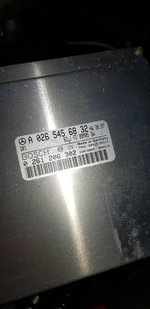

Drove to my locksmith with a box of parts and this time the plan was to lift the Chip from my original N54 and Solder into the Ebay N54. He also pulled the data from it to attempt a clone soon when other spare N54s arrive in the post.
He also turned the Engine ECU into a slut again. (Put the original file back in and de-virginized it)
Took those home and bingo the old original key fob is working 100%, the car opens, locks and starts up as it was before. It was clearly a hardware failure inside the original N54 board.
Phew is all I can say!!
We are going to create 2 more spare keys and also, crucially a spare N54 clone. Which I can keep in the glovebox as spare. This way it's no use to anyone without the key - but if it ever does this again and tries to strand me I'll have that unit to slot in which will work with the fobs and engine ECU. And keys can be ordered from the dealer no issues as it is running its own identity in the Ebay N54. Glad I didnt go any other route which would have been a rabbit hole!
FWIW This is the N54 Chip that we swapped and which holds both your key data and Engine ECU codes.

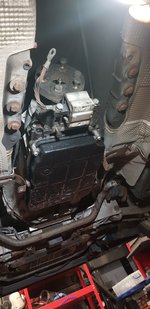

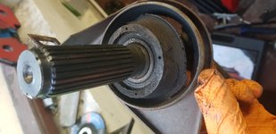

Finally getting around to starting to restore the Diff from my S320 140
20200809_120428.jpg20200809_120720.jpg20200809_120846.jpg20200809_121037.jpg20200809_141855.jpg20200809_143208.jpg
It's more of a clean, de-rust, re-seal, paint and fill with fresh gear oil. Both driveshafts are getting rebuilt next also then the lot will finally go back in some 12 months + later. Sigh - far too many projects I know!

Got stuck into the underbody disassembly on my S430 today.
The full exhaust system had to come off of course - the sections I had worked at before were fine and came apart super easy. The front down pipes not so much! The nuts in the manifolds spun so I had to reach in with mini vice grips and that did the trick. I will scope the cats to ensure nothing blocked or breaking up inside. New pair of 02 sensors going in and painting the front sections.
Full propshaft removed and the centre bearing is collapsed - which will be renewed along with both guibos. The centering bushings are good zero play since I got to it before anything let loose or had excessive runout etc.
Got all unhooked from the transmission and proped a block of wood between the engine and subframe so it would balance at a nice angle to pull out.
Then since she threw a ABS sensor code for rear right wheel I figured the reluctor ring would be the cause and it was. Replacing both as a pair and be done with it. My early w220 had bolted inner driveshafts (before the miserable types at MB deleted those bolts!!) Thus I thought that would be easy. Nope - had to remove the whole diff as there was zero room to free the inner ends of the drive shafts. Diff will be re-sealed too.
Next up is full removal of the front slam panel - rad pack etc. This will enable more restoration of inner body brackets etc and may chuck a new condenser in there since the AC system is stone empty and losing vacuum after 25 mins.
