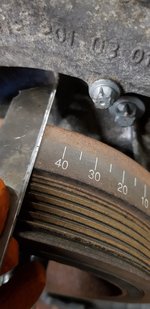

Next up was to check the timing chain for stretch. The left bank tool was very close to slipping in. The right bank tool was quite a bit off - indicating stretch. More specifically 8 degrees of stretch! That's quite a bit - glad I am replacing the chain, guides and tensioner!

The chain was stretched:
I then pulled the timing cover to reveal the chain and guides. The crank was first locked at 40 degrees after TDC and the cam locks installed. Then chain split and removed.
You know how the m119 timing rail pins remove? They knock out? Well the MB engineers decided to make the m113 such that the timing rails CANNOT be removed or replaced with the cylinder heads on!!!
The timing rails are captive in the cylinder heads and whilst the timing pins are screwed into the block, they do not unscrew and release the timing rails due to insuffiencent clearance!!
I have devised a solution
So as I say - when you read WIS MB calls for cylinder head removal. The timing guide rail pins are bolted into the block. Whilst you can get a wrench behind the rails when you try to unscrew the pins they bind up as there is no space to remove the rails in situ - the rails catch the heads. This SUCKS!!
But - I discovered a JC220 solution. Something you won't see anywhere but here :choochoo:
I discovered the long "bananna" rail comes out and I could check the pin per the above post photos.
It is an M8 thread and pin.
I can make my own replacement pins that will work. I will need to cut and break the old rails out. Then make my own guide pins from cut down M8 hardened bolts and M8 half nuts.
This was a test run for proof of concept I had filed down an M8 nut and part threaded M8 bolt: (original pins on right with fixed nut)
And replicated the original pin except crucially I can pass the pin through the guide rail, through the half nut and into the block. With threadlock for good measure.
Screw the pin in, then tighten the lock nut and have just as secure a pin as the original and allowing R&R of the timing rails with the cylinder heads ON :wootrock:
So I am replacing all 4x timing rails now using my method.
Now I know it works, I will go get some hardened M8 bolts and M8 half nuts tomorrow and make 6x custom timing rail pins as required to affix the 3 other rails.

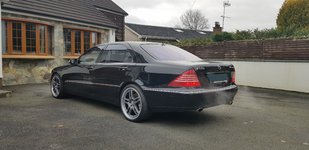

However my S600 is an amazing car. Really happy with it. Owned her about 1.5 years now and never misses a beat. 580hp and 910nm it is a total tyre shredding monster yet so smooth I can balance coins on the engine.
Taken on sat when I took it for a drive on dry roads:

Painter has my S600 again - should have it back early next week and hopefully it will be good this time so I can drive the darn thing.

S600 rear quarter re sprayed this eve so will get her back tomorrow...

I got my S600 back from repaint part 3 this evening. Got the free overspray etc but the right rear fender now looks decent at a glance. Finger's crossed the new paint doesnt "steam up" like the previous coat did

It was interesting to note the cam sprockets have no timing marks and no key. Therefore you install them finger tight on the left thread bolt, install and crimp new chain after pulling through and install tensioner. Then fully tension chain with cam locks in place and crank at TDC and only then tighten the centre left thread sprocket bolts. Thus the indexing of the cam sprockets rely soley on the clamp load of the bolts! However it is quite ingenious as the old slide rails do not interfere with accuracy of timing since you can set it without limits.
It was not a terribly exciting job I didn't take too many pictures but here are some:
Running again now zero faults zero leaks. Still want to test it for a bit to see if the rattle was indeed the chain or what the story is. When in there all the way to the chain it is my opinion to just change it out which is what I did. The old one did not appear too bad but time will tell.
