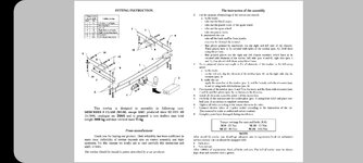

When I sold my high miler w211 the Towbar I fitted a few years back went with it. I do need a tow bar for very occasional use clearing up / DIY around my house. But fitting one to the daily driver is not ideal since when you sell the car you lose the towbar also and are back to sq 1. So I was going to buy one for my w221 but then realised by chance that detachable w140 towbars are available cheaper (£150 cheaper) and for me this makes more sense. Since I intend to keep the S320 therefore I'll have the towbar for many years VS if I put one on my w221 chances are that car will be changed in the next year or two.
Sacrilege yes but for me this makes sense to fit one on my S320 and it is detachable so not visible in most circumstances.
So this is purchased and on way from Germany (aftermarket not MB) and I will start checking what wiring it needs to work. Probably a by pass relay to be sure it doesn't mess with the w140 electrics. My S320 also has no parking sensors IIRC so this works out well since they won't be screaming at me with the trailer on either!
