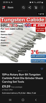

For most of my life I've wanted a die grinder, or even a "zizz" wheel after seeing how useful they are for so many things. I do have one now along with the compressor. Frozen bolts? Rusty bushings? No worries.
Yes they are Fantastic I have an m12 one and if you haven't got em already you really need bits like these too:
For example on that bushing removal I used the pointed cutter which makes for very fast accurate cutting and material removal. Far faster and more control than say trying to split with a blade.
