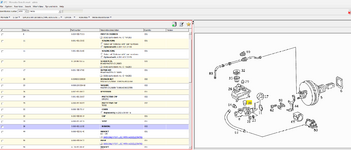

at M/C for sale there is quite a price variation. In your diagram, sealing ring, #11, popped.
That's my bet. Thanks for your prompt reply. Don.
Don, you'll need to do more investigation first. If the leak is from the booster, the booster could be full of brake fluid (but, you would have been adding a bunch of brake fluid over months/years to make that happen). If the booster is full of fluid, it will also need replacement in addition to the MC. The booster should always be 100% dry inside. Leaks out the rear of the MC are pretty rare.
Seal ring #11 is an air seal between the MC and booster, which is under vacuum with the engine running. Replacing that won't help. You will need to unbolt the MC from the booster and check for liquid out the rear of the MC and inside the booster.
