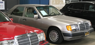

For what it is worth, to @Ntrepid's implication that his painter/bodyman selects his customers (as opposed to the other way around) when I first received my car and had a little bit of roof corrosion addressed, I had the paintwork done by a big paint shop called "European Collision Center" --- they do a lot of insurance work on late model "flashy brand" cars like Porsche, MB, Audi, Tesla, etc. They are very much a "production line" and the way they organize the shop and the process they use to crank insurance work is very impressive. It is apparent that they do a lot of volume and that they are optimized to handle that volume with a time-tested process.
European Collision also takes some work that is not insurance work, but they are picky on that kind of work --- I definitely feel like they are quite selective on the kinds of cars / owners they wanted to undertake on the non-insurance side of the business (pay out of pocket).
What helped my case is that one of the foreman type guys at the shop went gaga over the sight of a red w124 500E, as he was clearly a big fan of these cars. When I dropped off my car, he also very proudly showed me how they were in the process of a full teardown / repaint of a pedestrian 300E, shown below. Frankly I was amazed at the primo-condition of this 300E, and he mentioned to me that this was a $40K job to re-do the 300E, even though the car was worth nowhere near that amount. The car had a lot of sentimental value to the customer and the implication was this kind of work was the "customer profile / potential for word of mouth references" that they liked doing for the non-insurance side of the house.
You can tell that they tried to get everything perfect on the 300E --- even the passenger side mirror boot looks fresh and the grille shell is gleaming. The whole front end looks new.

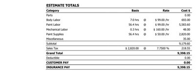

Got a response back.
"Here is the estimate to repaint the C43. This contains NO body work repairs and assumes the car is ready for prep/priming. No removal of items has been input."
