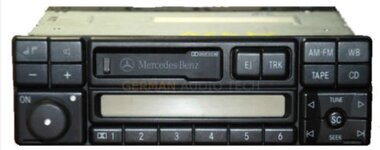

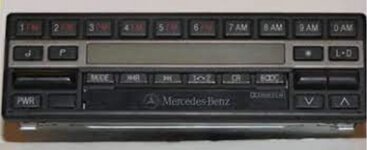

If the radio is (or is a variant of) the later BE1492 unit with a volume knob (found in US W124s model years 1994 and 1995), rathar than the BE1432 generation with the volume "bar," (as found in the US-model W124s through model year 1993) then it is likely your volume knob's rotary encoder (sort of like a potentiometer) has failed.
This is a very common failure of this component, and can be fixed by a competent, Becker-knowledgable radio repair shop. Becker North America, in the US state of New Jersey, can also fix this issue, permanently, by replacing the rotary encoder with a totally different component that does not fail. I had them do this a couple of years ago with my BE1492, and they added Bluetooth capability to the unit at the same time. It's worth sending your unit to Becker NA for a refirb (they will take care of the cassette unit and anything else that needs maintenance/replacement/refurbishing at the same time).
BE1492 (many variants are similar) -- all have a volume "knob"

BE1432 -- all variants have a volume "bar"

Mine's a Becker BE1150, but I assume the same prognosis applies? Good to know its probably repairable.

Yes, you have a BE1492-variant head unit. It's certainly repairable, and this issue with the rotary encoder is very very well known and has been an issue for decades.
