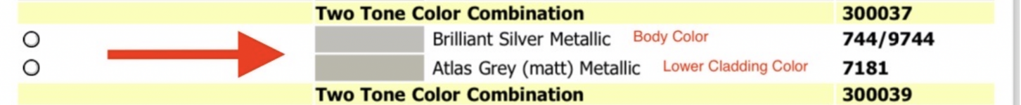

My '92 in brilliant silver is being painted as I type (finally!)...bare metal, glass out. I provided the painter with the codes that are pinned at the top of this section (below), and he had a question regarding "matt" for the cladding/lower area, #7181.
Specifically, we were trying to figure out if the Atlas Grey was "matt" as it might have been defined in 1992 and, therefore, more of a semi-gloss today, or was it really a matte finish.
I left a message with MB Classic and what sounded like a "seasoned" gentlemen just called me back; he said it's not a matt/matte but rather a "silk gloss," which is closer to a semi-gloss, and, of course, not as glossy as the brilliant silver paint above it.
This explanation was quite helpful on my end of things, so I just thought I'd share.

Bob, I think all the Atlas Gray parts have more of a semi-gloss finish, not what we'd consider "matte" today. However, I'm not even close to being an SME when it comes to paint / finish details. Hopefully others can chime in with more positive reinforcement. What brand / type of paint is being sprayed, btw? DuPont, Sikkens, BASF, Glasurit, etc etc? Will you apply clear PPF once it cures?

Hi, Dave.
Thanks. Agree 100% about it being more semi-gloss, but was seriously second-guessing myself because of some images I saw on BaT and elsewhere, on top of the use of the word "matt."
