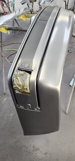

Below is a photo journey of the process. One thing that came up as a cloud (with a silver lining) was rust that I did not even dream was there. I'm the third owner, and the first one (CEO of a well-known company) lived in Cleveland but spent winters in AZ -- the car was in a climate controlled garage while he was away; the second owner (a physician) lived in temperate North Carolina. Didn't matter. You'll see rust that appeared/destroyed the driver-side accumulator bracket, and appeared around the rear window thanks to a ham-fisted replacement (we think) by a previous owner. There's more, but in small doses, thankfully. The silver lining: David is an insanely talented welder, and very well educated on our cars. He knows that the metallurgical properties vary depending upon the part of the car we were dealing with, so he made sure to match those qualities/properties with each area he treated. How? He found MB parts with matching metals at a salvage yard and applied them to the corresponding areas. In the case of the accumulator, the bracket was so far gone he had to re-fashion a new one. You'll see that below. While I am not a welding expert by any stretch, I have friends who are and they spoke highly of his craftsmanship.
You'll see that we added weep holes to the bottom of the rocker panels behind each front wheel to avoid any sitting water/elements in the future. It was clearly a design flaw not to have them in the first place, IMHO.
Thanks for getting through a long pre-amble but I thought it was important to create context. Right now the car is getting PPF applied to the front end, including the (insanely valuable) headlights, full hood, mirrors and rocker panels down the length of the car. For those that are interested, Auto Paint Guard in Tampa is doing that work, and will add a ceramic coating to all surfaces when I'm back in a month or so. Yes, Pierre recommended them and so did a number of other people I know/trust in the area.

While not clear from a distance, one can really see the crazing in the clearcoat on top of the trunk and below the C-pillar/sail.

Body sanding, prep-prep and more prep, etc.
View attachment 196987View attachment 196988View attachment 196989View attachment 196990View attachment 196991
View attachment 197016View attachment 197017View attachment 197018View attachment 197019View attachment 197021View attachment 197022View attachment 197023View attachment 197024View attachment 197025View attachment 197026
And voila! Pictures from this past Sunday when I picked it up. It was harsh, midday sun so detail is missing is some shots, but trust me, David's work speaks for itself and I was over the moon.
View attachment 197027View attachment 197028View attachment 197030View attachment 197031View attachment 197032View attachment 197033View attachment 197034View attachment 197035View attachment 197036
