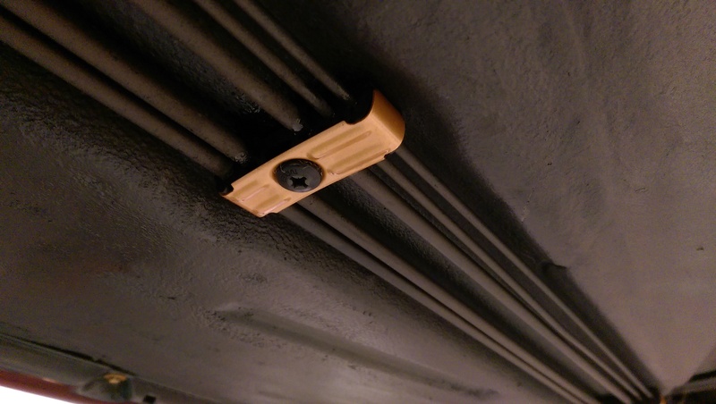

First of all i got new clamps for the brakelines and fuel lines under the car.The SLS clamps have not arrived yet.
Here is the old clamps and rubbers.
All New parts :)
And nerdy me..i cant put em on without putting my touch on it.Soooo.... i put a coat of 1K primer..and three layers of paint..and two layers of clear coat.
And finally on the car...and i am really happy with the result.
I even got to mount the rear clamp where i repaired the rust in the floor...made a new pin in the floor..so i could use the original plastic screw/nut in the middle of the clamp :)
