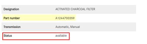

I just missed one on eBay. They show up as NLA on Revolution MB sites
I'm not seeing NLA at RevPart sites, yet. MBCC shows available (click here).
RevParts usually has 3 different terms that show on their website. They do not all mean the same thing:
Discontinued = NLA (however, if a part comes back from the dead, RevParts can be slow to reverse this)
Currently Unavailable = Probably Available, but may not be stocked in USA, and needs to come out of Germany.
Backordered = Same as "Currently Unavailable".
In all cases, you must contact a live person at a dealership and have them check worldwide inventory in Paragon. RevParts websites DO NOT have any connection to real-time inventory and OFTEN do not reflect reality...
:klink:
