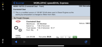

Hi guys was told by my friend mechanic that the Diesel engine seal is of better quality . It is vit-on not rubber .
Is this true?
