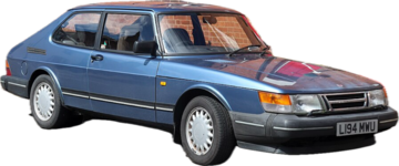

I was going off this as a 900 which has different door handles and no 3rd window on the side:
I probably shouldn’t argue with a Swede about Saab car identification 😀
The car that replaced the old 900 in your picture was named 900 for a couple of years until SAAB changed its nomenclature just like Mercedes did, changing the 900 to the 9-3 while being the exact same car.
The five door variant of the car in your picture also have the 3rd side window btw, it only disappear on the coupes for both generations.
Confusing indeed, especially since there was an old SAAB named 93 decades before.
Sorry for the off topic but I do love a SAAB discussion. 😊
