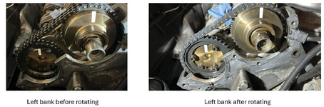

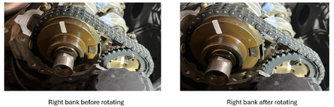

If I'm reading those correctly, you have cams at 0°, two at 20-ish degrees, and one around 40°.
The zero appears to be 2 teeth off, the two at 20-ish are likely 1 tooth off. You'll need to loosen the chain and rotate the cams until you can get all four cams reading near 40-45°. Remember that the cams may "jump" when tension is released. It won't be fun to correct this.
Thanks, I’m really perplexed how this has happened because I only disturbed the exhaust cam with the bad lifter as far as I was aware.
I’m busy for the next couple of weekends so won’t be able to correct this straightaway.
I’m guessing they all “off” in the same direction too? Seems odd to me that the one I removed is potentially correct and the other’s aren’t.

Weird stuff can happen when the chain is loosened. I don't have an explanation, but I've experienced this too. This is why I tell people to triple-check the cam timing when the work is complete, because it's no fun to tear it apart second time just to check cam timing (and then fix it).

Were these markings related to some previous re-timing activity? Are they chalk or some kind of dry based material?
I think part my problem came from using ancient correction fluid to mark my cams. It is almost impossible to buy it new over here (probably everywhere) in a bottle with a brush to apply it and with the oily surfaces and the months I've taken to do this work they effectively disappeared.
It is the not knowing why that is bugging me, I have spent ages following the MB docs and youtube videos and the advice from here so it really shouldn't have happened.
See my above comment - my poor choice of cam marking material was definitely a factor I'm sure.
The marks were fingernail polish that I "borrowed" from my wife -- albeit with her permission. Pink and orange are colors that she does not commonly use/wear. I think I also made a third mark with a black Sharpie marker, but the black ink can potentially be dissolved through handling, motor oil, brake cleaner solvent, etc. I also like having multiple (two or three) separately colored points of reference. This makes everything visually MUCH more sure and able to line up.

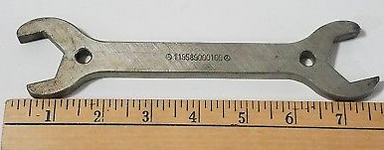

I think not using the correct tool was a major factor so we made these, the centres are ~138mm apart:
Hopefully I will never need to use them again :)
The next jobs are to replace the front covers and fit the power steering pump and then the chain guides and valve covers, plugs etc. can go back on.
I have no clue as to the cost or availability of the MB OEM tool especially in the UK. This is a nice improvisation of one. It looks precise and even adjustable if needed and it did the job.:thumbsup2:
Me neither but probably expensive if still available and a special order.
These were made from 2 different sizes of round bar which was tapped and threaded but you could use M6 studding and threaded collars. They were made fully adjustable so they would definitely fit.
