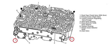

If it's valve body issue, possibly easy to look at #7 plunger/selector, with transmission pan off, with 2 people, so whoever is under the car can see if the movement of that plunger is adequate through all the manual shifts? I don't recall that plunger has any valves within in it, literally just a mechanical "syringe" ... Maybe some debris accumulated in it's receiving cavity?
32361663828_36898afdd9_c.jpg722.3_valve_body by Duh_Vinci, on Flickr
