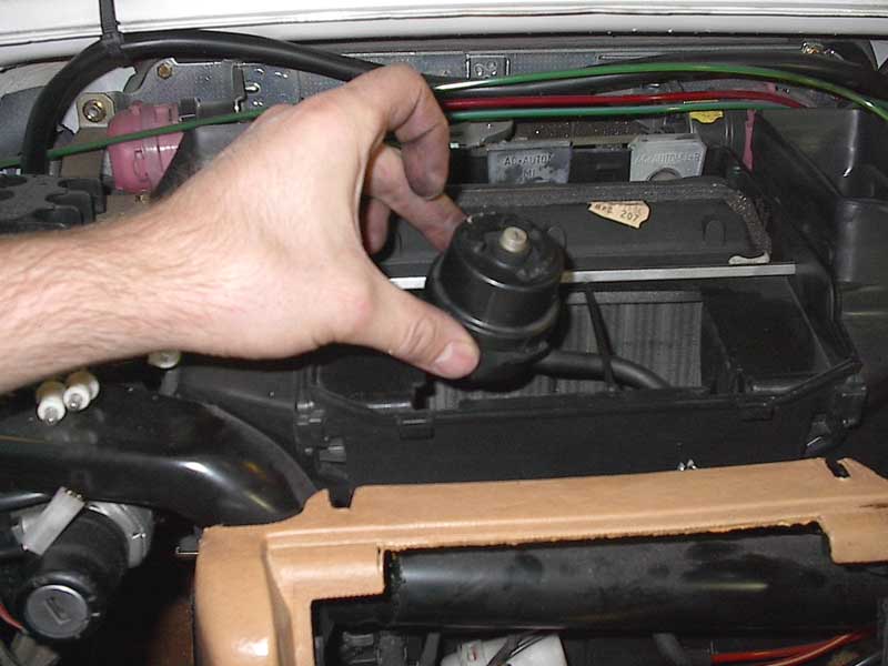

Uhhh....been there done that !! Documented it too. You can remove the pod by slightly bending and removing the top flap of the box, and pulling the pod out through the top.
If your hands are small enough.
I chose to buy a few spares when word got out the were being discontinued.
I'm not pulling a dash in a bone yard for a $20 vacuum element.

Hmmm...a pinkClarkomino dashboard. Could that be Vader removing that pod from that box ... ?
You selling those spare pods for $55, tops ?!? :stickpoke:

I would pull the case and do it right. The fresh air/recirc pods are a bitch.
And I'd inspect the evaporator while I was in there.
And I don't know anyone who leaves the console in doing this repair.
That looks like a thread Dave did in November 2002.
So I'll excuse the way he did the repair, but Gerry......... taking credit for Dave's work ??
No .. HE inserted the photo in MY post, after the fact. I still appreciated it though, if only to give me an opportunity to make a crack about Clarkomino and "$55, tops!"
