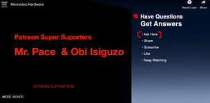

I might be mistaken but seeing this always makes me chuckle, I don't EVER remember seeing any comment from PH in response to a question posted by a viewer on ANY of his videos:
At least Mr Bergsma [aka "Uncle Kent" - Ed.] disables comments on his uploads...:)
Yeah, Uncle Kent started turning off comments on his videos some time back. LOL. He didn't used to.
Indeed, don't recall seeing Cousin Pierre answer any comments on his videos. There was quite a bit of 500E-related banter on his recent video dissing the 500E, and not a reply in sight..... :stickpoke:
He certainly knows this forum too, but I've never seen him post here. Dollars to donuts that a lot of these shop owners (including Uncle Kent and Cousin Pierre) come to this forum as an information resource when an M119 or .034/.036 enters their shop doors. Certainly we have quite a few other shop owners and mechanics as members here - as viewed by the email addresses of various members I've seen (not counting @jhodg5ck )
