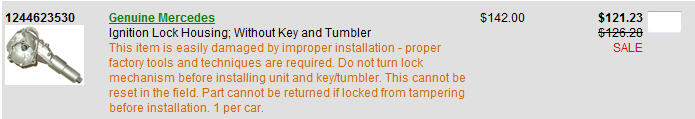

Still nothing.....I think it's locked up too....I am assuming this is what I need to order:
I believe if you turn the lock cylinder when the switch is out, then it permanently locks (ruins) the mechanism. There is a fair amount of info, and cautions relating to this, posted to the forums at PeachParts and Banzworld. You need to Google it.

You can get a genuine MB part much cheaper than AutohausAZ's price you posted, if you go through parts.com.
