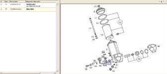

The part number is 006 542 94 17 and I would also get a new sealing ring part number N 007603 012113 to go with it.
Naperville (MB OEM Parts) lists the prices for these items as:
Sender: $68.40 (list price $95)
O-ring: $1.08 (list price $1.50)
Note: Pricing as of Feb-2012.
Sender: $76.96 (list price $104)
O-ring: $0.74 (list price $1.00)
Note: Pricing as of Aug-2018.
Hope this helps.
