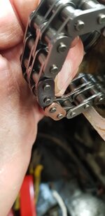

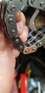

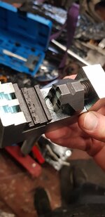

Dave, I’m smiling my way through this—thankfully, the crankshaft sprockets are intact. I appreciate the part numbers; that’s exactly where I planned to start. Now I just need to figure out how to properly crimp the chain. This project has definitely turned out to be more than I bargained for!

If it helps I use a chain crimper like this which produces factory quality crimps on MB timing chains
