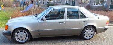

The last bit of good news is that my Rials have finally been installed. Again: what a difference. Yes, it's slightly more stiff, you feel bumps and other nasty stuff more, but it's sooo worth it. Not just because of the looks, but also because of the handling. I've only gotten to 160/170kmh, but that already felt much more secure, somehow. Less wobbly, less effort to keep it going straight.
When summer finally comes, I'll make some proper pictures, for now, these will have to do.
I hope you guys agree with me: this looks much better than the original look! (And yes, I still need spacers - soon!)
