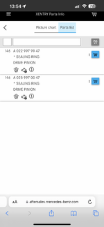

Admittedly, I'm using a free online EPC. Would someone mind confirming that either 0229979947 or 0259970047 is the correct pinion seal for a 1995 E420? VIN: WDBEA34E9SC158976.
Thank you.
IIRC the 2 p/n's are interchangeable, and are a slightly different design... if both are available at the dealer (call before ordering online!!), the 022- is a fraction of the price of the 025-.

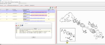

As FYI... in addition to different part numbers for ASR (32mm axles) and non-ASR (25mm axles), there was also a change for very late production 124's. Chassis break is C241286 / C241287, which is about March 1995 production. 036's will all use the "early" version.
NON-ASR boot kit = 124-350-08-37
ASR boot kit = 124-350-07-37
Very late production would be #09 (non-ASR) and #05 (ASR).
Some or all of these may be NLA, I'm not sure... MBCC shows no results, which is odd.

AFAICT the difference is the width of the clamps, either 7mm or 9mm - screenshot below. The late stuff switched to narrower clamps.
Mike's chassis is C158976 which would be June 1994 production, well before the break point.
