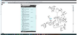

My 1993 400E power steering fluid was leaking from the day I purchased my car, back in August of 2014. Over the last 5.5 years/26k mi I had to add a total of 4/5 of a quart of MB steering fluid. My indy says it's the pump, but as I understand from reading on the forum, oftentimes it's a hose between reservoir and the pump (#47 on the diagram), so I'd like to try that first...

I think - I will double check - my pump is made by Vickers, so I'll be getting part #A0069970982. Xentry portal has two entries for this part #. What do highlighted in orange notes mean? Why are there 2 entries for the same part #? I'm just getting acquainted with using EPC.
2. How likely that the fitting (#17 on the diagram) needs to be replaced?
Thanks!
There are two different entries, because there are two different types of tandem pumps: Vickers, and ZF. Basically though, the "short hose" is the same. I recommend you add perhaps 0.5-1 cm to the length of the hose, just to provide a bit of extra length.
The orange note "TO 129 460 16 80" and "129 460 18 80" and "TO 129 460 27 80" denotes different tandem pump part numbers. Meaning that the short hose length leads TO the tandem pump. Different chassis used different pump numbers.
The "970, 971, 972, 974, 975" notations denote different variants of the M119.97x engine, as used in the W140, R129 and W124 chassis. For the 500E/E500, the relevant number is .974. For the 400E/E420, the relevant number is .975. The 970, 971 and 972 numbers are for the R129 and W140.
That is a tubular metal fitting (#17) and thus WILL NOT need to be replaced. It fits INSIDE of the short-hose.
The HOW-TO on rebuilding the tandem pump should be helpful in seeing all of the parts and how things are taken apart, and put back together.
Apparently the newfangled XPISS is lacking in some areas. The crusty old EPC is much more clear in this case. Screen shot below.
1) The references to 970, 971, etc are meaningless. All the .97x engines use the same part number hose! You need to know the LENGTH of hose for the application (see #2 below).
2) You need to know the LENGTH of the hose required for Vickers-LuK or ZF pumps. Ignore the pump part numbers shown, the important item is the pump manufacturer: ZF = 53mm, and LuK = 76mm. This is shown in XPISS but is overshadowed by the superfluous 970/971/972/974/975 notation.
3) Why are there 2 entries for the same part #? Because the same hose is used with multiple different pumps on the same chassis/engine combinatoin. The "other" pumps are either ZF vs LuK, and/or models with SLS (tandem pump) vs without SLS (standard, non-tandem pump). The R129 and W124 share identical pumps, all have a 129- prefix. The W140 has pumps with identical dimensions, but slightly different pressure ratings, and a 140-prefix.
4) Gerry is correct, fitting #17 does not need replacement unless you damage it (unlikely). A new aluminum seal ring (#20) is recommended but the old one could be re-used in a pinch, if undamaged.

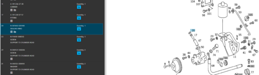

Lastly, sealing ring (#20) that @nocfn mentioned above - replace it too:
