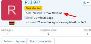

OP appears to be in Germany however, the suggestion to source an appropriate engine is still valid and the recommended route although probably more expensive than a US engine.
@Robi97 eBay is probably a good place to start looking.
That's generally evidence of a spammer for an insta-ban, but given the original question, I think the member is probably legit, as the question is pretty specific.
