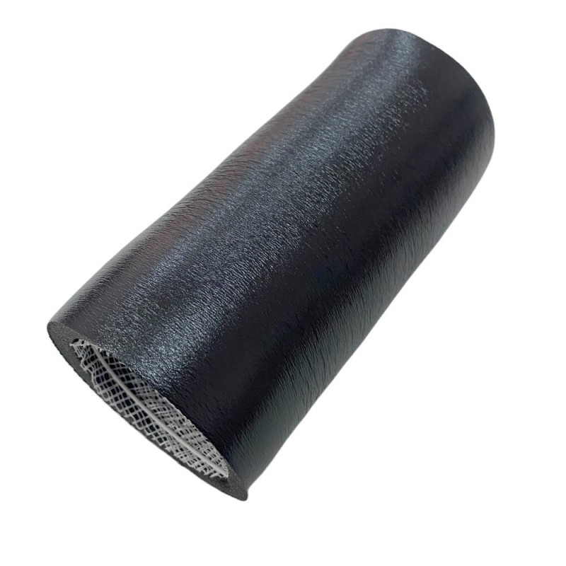

I contacted the manger, he is offering a significant special discount for the forum members!
@gerryvz How can we offer this to forum members? sticky?
Just post a Parts For Sale thread with a group buy or the special pricing, and details. Probably can get the best price with a group buy of XX pieces....

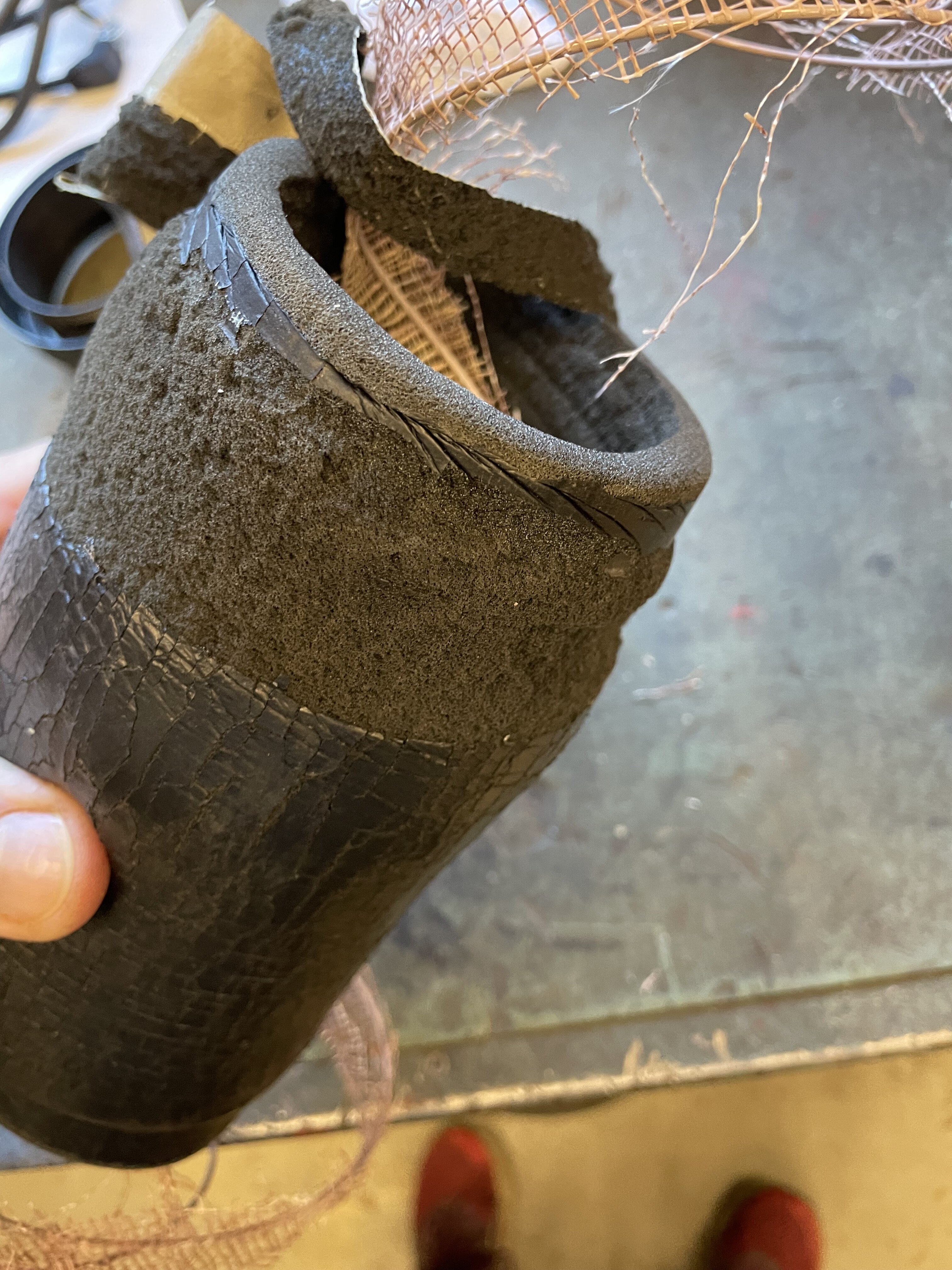

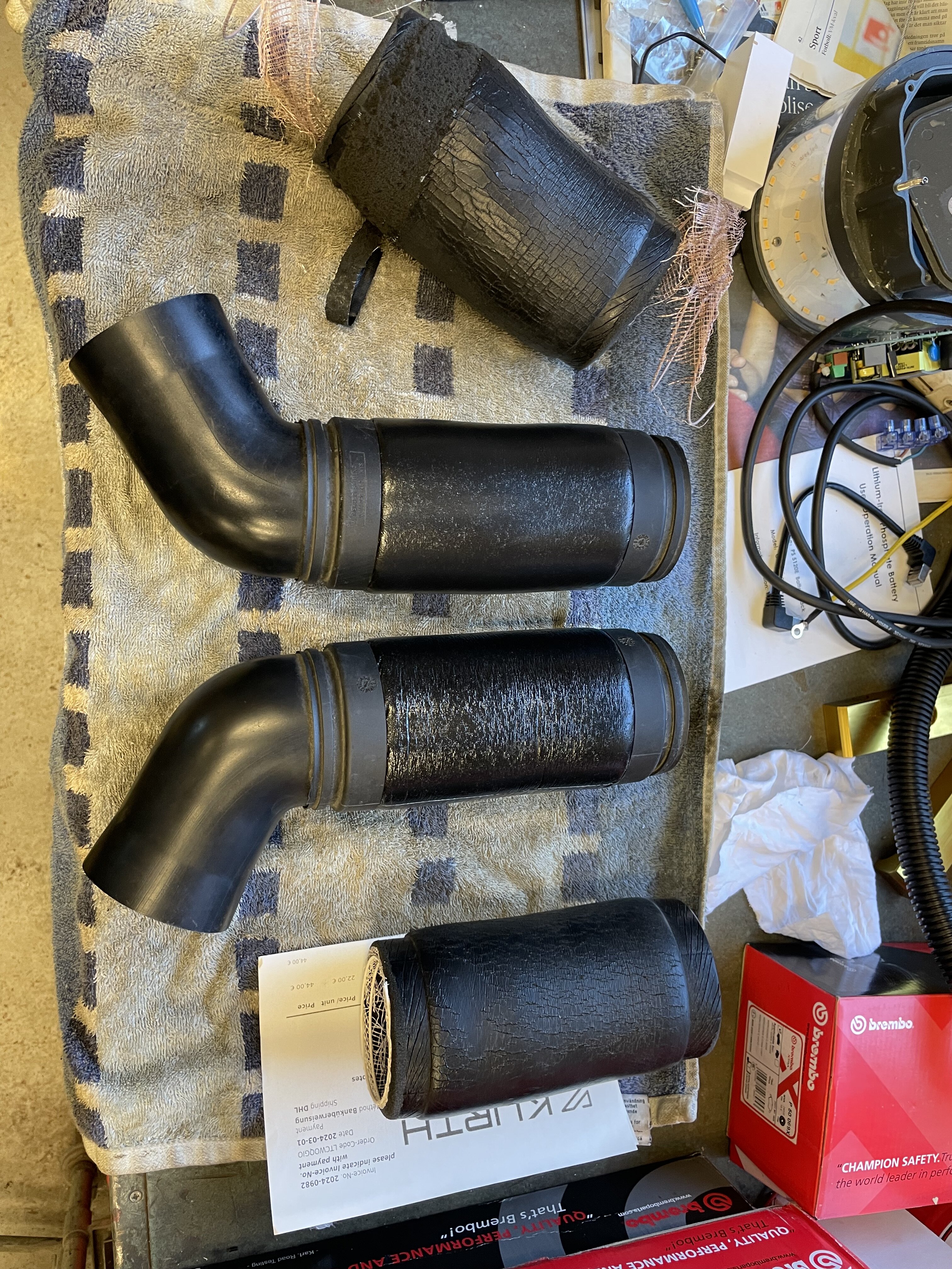

I got the delivery of the hoses today
Have someone do the job,
Shift the hoses?
Best Regards
Niklas
Niklas, I tried to explain how to take the hoses apart in this thread, post #35:

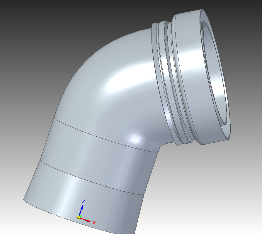

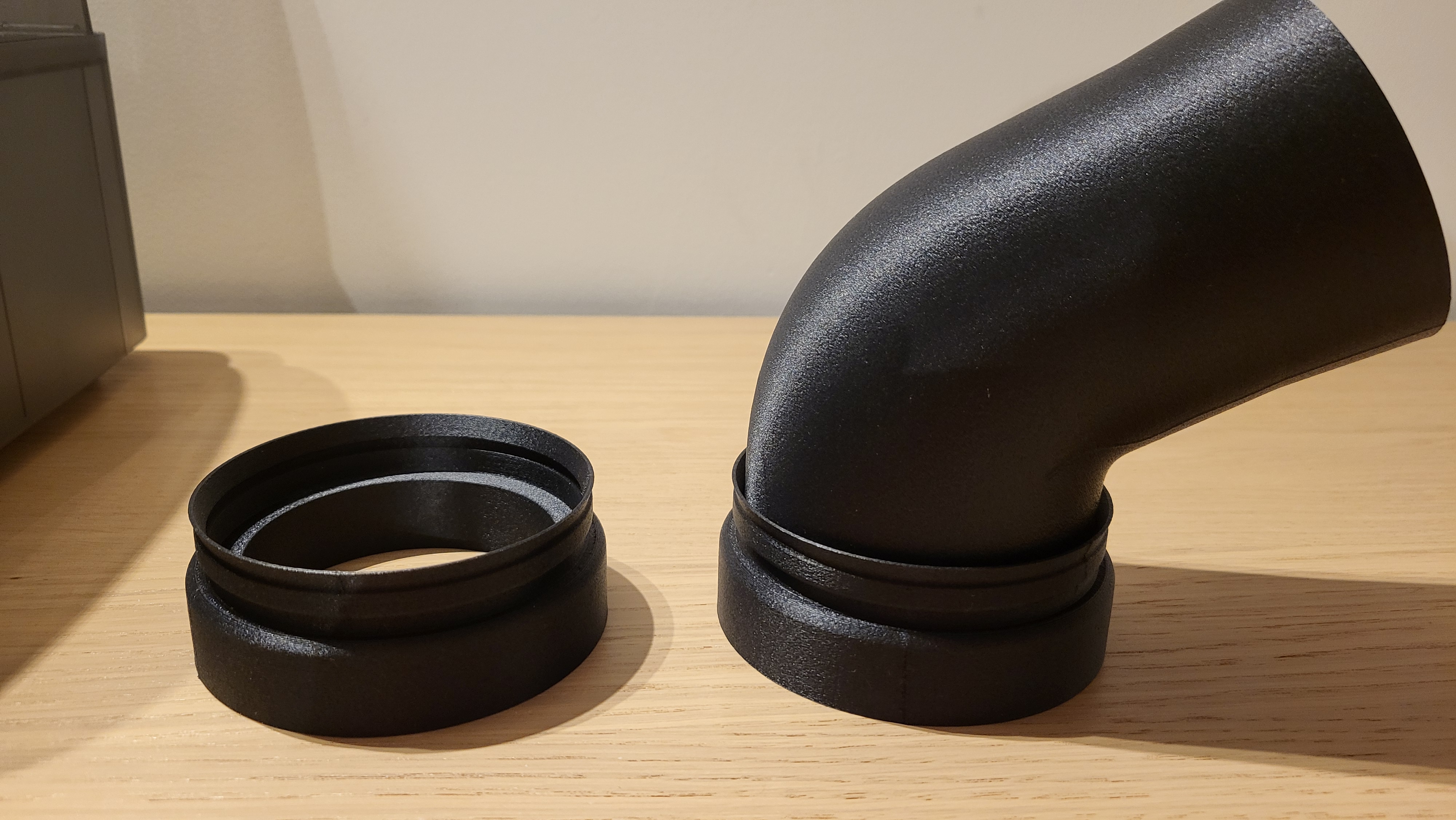

I'm thinking about 3D printing the plastic parts of the intake tubes. I wonder if there will be any demand for them, because it's always the foam that is damaged. For now, I printed the prototype with PET-G, but the final product would be made out of something more durable.

Here they are. Printed out from Carbon fiber reinforced nylon, heat-resistant up to 194°C (381°F), according to the manufacturer of this filament. I don't have any way to test them until the spring comes, but if someone needs them asap before testing, PM me, there will be a discount and in exchange I would like to receive information if they are holding up in the engine bay. Price is $90 for one side (foam piece not included).
I'm happy with the way that they look. Finish is similar to the distributor cover.

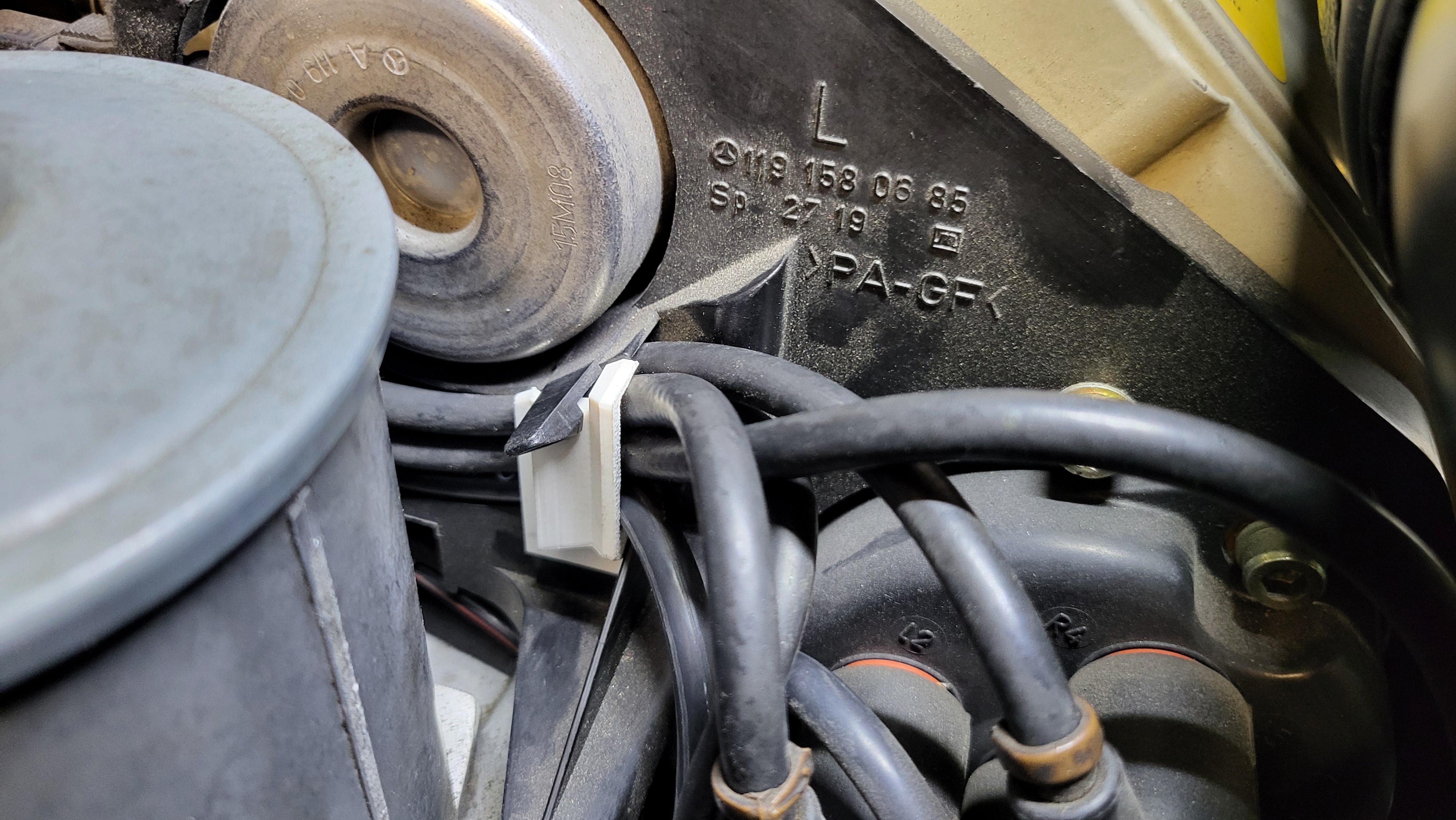

I also made 3D model of the ignition wires clip. It will be printed in the same material.
