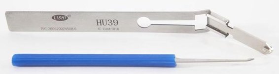

Two pick sets for the W124 Huf HU39 lock. The first one is a traditional tension bar and wafer depressor. The more complex one (second picture) can decode the lock and pick multiple wafers at once. These locks are tricky to pick. It's easy to overlift a wafer and if you're not careful, you can get the pick jammed in the lock cylinder too.
Thankyou very much for the suggestion! The second 2in1 pick looks like it might give me half a chance of success as a DIYr. There are You Tube tutorials on those Lishi tools too but off hand do you know if they come with instructions? Ie; from what I have seen on the videos some lock tumblers should be picked in a certain order.

Hmmmm most online UK shops will not allow me to buy the Lishi HU39 tool :?
Whose visage do you think is emblazoned on that diabolically clever tool shown? The mole inside the tumbler factory who got them made?
And what does it say below the portrait?
I believe the lettering should stand for Lishi. The brand name of the tool maker and from what I can see they are a pro quality tool. But also heavily knocked off so it’s wise to try and get from a proper vendor.

As it happens I did spot one Lishi blind pick good used on ebay being sold by a locksmith this morning. So I bought it:
Then I messaged him and asked in the off chance did he have one of the 2 in 1 MB types for w124 HU39. He came back and said no but that he would be willing to buy one for me at his cost and send it to me. Result! I asked him to do that so I will have both pretty soon I hope :)
EDIT: All sorted he is kind enough to go tomorrow and pick me this one up:
https://tradelocks.co.uk/genuine-lishi-t3-t11-hu39-3-in-1-pick-and-decoder.html
