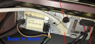

Finally had some time to look at this. I misspoke when I said the L channel drops out on CD - it only drops out only w radio, CD and tape work great. I took out the covers on the L side of the trunk and tried playing around w the amps, swapping L and R to no avail. I then took apart the tuner and everything looked fine to my eye, nothing obvious. I took out the only card/module I could, sprayed DeOxit where I could and....no luck. I was also left w this extraneous brown wire with a single spade connector. Any ideas where this would go and ways to fix it? Might just send it back to Becker Auto Sound, but adding BT and refrubing the tuner is $370....ouch. Hopefully it's just in the head unit and not the tuner, so maybe I'd get the BT and the fix to this for <$200
Hi, See the attached diagram and photo. The brown wire is ground for the shielded cable that carries signal to the amplifiers, and is supposed to co-locate with the connector as shown.
