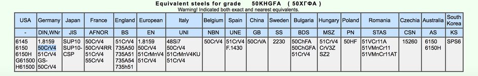

1) From the web - Image One ( Note: 50CrV4 )
- H&R Sway Bar Google Search

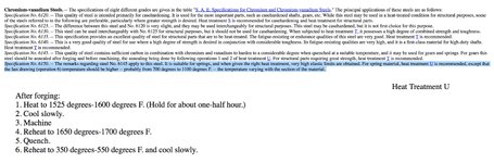

2) From the web - Image Two ( Note: 50CrV4 = 6150 )
- http://www.splav-kharkov.com/en/e_mat_start.php?name_id=596
