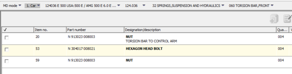

Could you tell me where I can get the 4 bolts and 8 nuts for the front sway bar. I have not been unable to source any yet, and I do not want to reuse the old ones.
EPC has the factory MB part numbers, screen shots below. The nuts may be compression-type (self-locking). The bolts are nothing special, you could get generic metric bolts from the local hardware store of the same size.
Phenomenal. Thank you. I had searched everywhere and couldn't find anything. How difficult is it to get the EPC?
