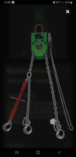

I did the job a couple of times, with a proper engine hoist and load leveler. Same the factory did. It's a tight fit but with the right equipment and some experience it's done quite quickly.
Actually quite satisfying to see that massive thing diving into its position.
Much easer it would have been if the 036 would have got a removable upper radiator bridge as the W201 2.6es
Best to use the Wilbaer load leveler which is capable of quite steep tilting angles

I guess the rear end of the transmission will come down a bit, how much ground clearance is necessary to have underneath car?
Like about 25/30cm, usually having the car on a 2 post hoist with the wheels touching the ground. In the end enough that the engine crane legs go under the car without hitting. It
