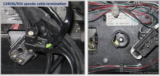

Yes, it has a VSS cable to the speedo, but the cable is not a coax type (...if that was the question)

Thanks Arnt, I want to skip my coax connection and replace it with the VSS wire as its a more solid link.
